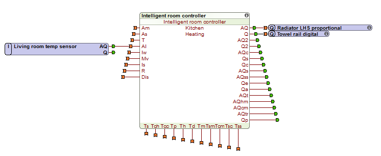

Пример функционального блока "Комнатный регулятор"
The intelligent room controller takes time to learn the thermal dynamics of the room. We recommend setting up the schedules and then leaving the controller for a few days or ideally a week so that it can learn.
Even with really straighforward programming the Intelligent room controller can be made to be fully functional for individual room control in an automatic mode.
First connect the temperature sensor in the room to the input AI, then either or both a proportional valve actuator to the output AQ or a digital actuator to Q. That's it! Now the schedules can be set easily in the UI with the Apps or the webinterface.
For more information on how to setup the room controller to work with the automatic blinds block see the seminar at the top of the page. (ссылка устарела) can be downloaded an example file as well.

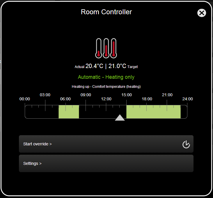

User interface
It is very straightforward to set the schedules in the user interface, here is a picture of what the user interface for the Intelligent room controller looks like:

Какой-то кострубатый у Лохона комнатный регулятор. В том же KNX все намного лаконичнее и понятнее для человека с улицы.

Давайте сравним комнатный регулятор. Loxone я уже выложил. Нужен от KNX и Crestron.
