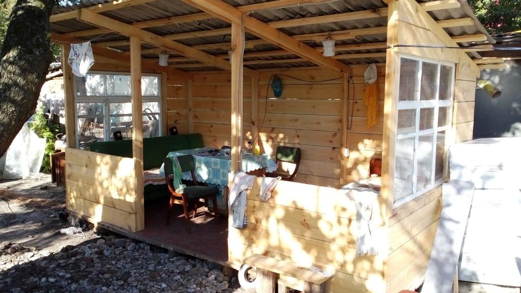

Так от, до бесідки. Її я побудував впершу чергу, оскільки то був літній варіант житла.
Було:
uGFvt-YpkdlUB-DjMSwyIE0c90wqosNet82-5GuClw-LUA3dCsXdCOldtiO49l4Ey0ahzRetRQYJ6rV2ZoCo0UqYoOWZw1uCuhG004Y-eDKub2Y1fBhZDi7eR-V0O5C2ICyZDICR_qJ-QplvlVXnIy2c-86rO5GCNm9-nN8fLi35iIa-lnEnv8MRGfkCWNeOjkE1ipdqQXG8rZpugeC16xLQjwTvZwTJPkGT0tIhoZPMdlguiEeSRQmVuHfmP7VlG_3odiTb77KOnDpXERZmFG4gVgDVl_-2EsUOQiMDBrtxU34FM7ZaQ-ZPVfS2Yko1ttc-LUHYg0nn5OA2t49mxILxIb_i0Jorpp0Ysdkm0wdEsrnGw3s-gJvMmaSVSz505yPivQivPDu6rbzj7Jt3R52hWHCHPW43WXzxuSCGsZ8TgqhkD1kfVGbSRoWYLjnVxoxudTUQTH2D6WiZHvVWVxhvrRdnKkxJjQKfrN76cpr7uV-SSR3ukkr6gh9KfTMKsrtGrgRx5Xfz5CsoyPKaDW9dmgqOUQif0pyp38k8CYcxGxW5nMuNtrvPggB4whJ48uZKVumtvZC1Xe4vIMJp0OAf6MNOe1B3yhmiavoO0hRBcH4cdD6n2_5dqpDyeK8emSF0hjksYnZSwaj5ncrkygoGEt4ioyHnFI-qze5HrA=w1090-h613-no

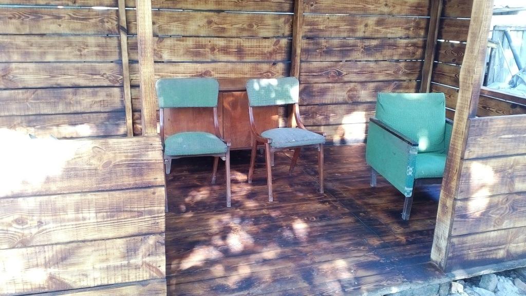

Стало:
0XbDwBFw5dlSQJD447Zw6JtASA9mTMRaH9FBxc1JlnBcLXc5lcq1UFlYvHkbAlZVw76LvUgnSSjnn8D5fD2uqSRHLsq4wKZnD29wmd2rDX_bvLI_rlhDcEoz4MnVFl207fS9V82SHzNaWW1lf6FbLpRWi7xpV77GNCgjWlsnhH2uTREUbVUgX6HFqVj3rtjh0jjopNhN-EqHDng3qaBD2kShj5lFMpsxEH4kA5mfsYTyNepNJ1Yo8l2YPgz9DmhYENRfPnjoEKKAE0Gu6BBOcAyCq3MemXxNDAhsrMSD-RtYEP6_IzRmO3deN_u2flWN8cp3bbGHl7opNMkaFrb39ryc9WyWQFrLRC91fYJo976nfl4ffNoO_lMz3Gq1gfT8eQfN6wUXKWNfvx4dWSQmNrdKXjkwfHUIonWGSfs7tNt3mQ73bDdPbocHn8VmJqQQ5uHStEqqcKe6T9lLByX8S65WzBEFW8RN3gHk_YIy_4Z8vR2Aq_CuOb8bWaGaXciRp94uGQv91ABo8DpJP9qAvb8YuW5H8E2PXRfpM5ztXgZcUXuyI5kekjpJTV6v2dbRmjRZwPQOxzerC1aU5Ami2aHD4RB2q123oVdbHLcRnns2vqr1deksz6NXg9gbq7QGDZEZQiDLvea_cQw0nNNqZbFV7NGGx9kCX8Qf2hLaIQ=w1090-h613-no
LaJLD59p-6B7VadGrqWcUDrPBtFBovrHBU3XBx6IUP_F_8Nzwbs9hLzV0qeAyKsfLjhXrwYghwaCEfi2RvDvydt594QgYPSX4tUpsgWAnbDqrgmMADHt1DMXrcjWyW-DsK-t_ew396JumnbeXrkf_tH334RdmW14LBkfPDGmUlw1md7AqhQvyP3rcvXa88Rm1-uQD59mcMylO8Uq2DCtMcbtu67ThxLW544JC01pn7P5b3aoLJbTWjDdsbv6Lev2kcjHWEhas1WlD7t8KZHst-zlEWLPXPqQ1zYWUnnY_V0mGtYW449B2MIju2p8mxWZjmTN6DxWbB63ZRyg00v9Hx0_PxjZThloRZGq8duHyN6rgsHPgx_c40asaIcWUIg2IRSuPFKdEECk_p63jFjUEJJl8SLqNkbFNmwnsefKQmYJpvOHrRETVaCE8QuQufvBB1eIjR7ju7y3lGJ-G5Vk1gxtAG1kkudLPrmTFk23qOXPE8pW6VKKP2TzQ7WUcwvgVFhGGlgVA_T9B6S8KkPK2K4qG3kCrLvZAMA2YtwMBDVVUUJjM6nD2h2E90RCuXBjtK053uy7_rBEIc9NqW5WzeJsLivn8_c6Wdowo8qEShXuSjtnIrzHZ8x8O9uzwps-yEhWrGHD7c6jOsMpwtWWpAKwgqFCtoZ5Fy1GklRcjA=w1090-h613-no
Vvb-X0XklGFWznM68lA-QCArPh8RCvPOo06O2I5fiA8h0WizfJluZ8MOJGdPmG1uQjWRtCvc_kr0lko0Ce5icVojcI63Nz9BnWWf3vqClBNMpZTvtwkU1nIrQ-FN3Xeudn-K-KROHieGW6TuX8p_bbHGryaz26LGqbtIb1x2_pVXJ1QvvDBpH3zz8a1S6z1Sl4x5B7icCB_Y8a1rvPF9OghSaTP600XZe6tpUlpSy2CfXZSYPTrCwnSzwKqkT-AVeGGGbgWZsQhp6oSGRUtQGgbR6j5WEiadbaVmp1j89YAaLFglhi6e1coNnoPgTICIRyJgv1KFZX_ZjUikSRbnMnd_Bp2_8S8x7lH1w00DeXWokoSeNU8i6aXNkheblvanw1n7OqDhDwKJgIA9bWFsgEJyhioTHxINdTXWvhaukB7Ku0V23OPa_so9416MaVgoM0bS5LlhPXAmilb1n1iGQegXkipTl3Sh8N_Qp2NtYOYnCQcGuNiVcHJWQ-keRky0wZQuHPRxYsY3MyYOOUtX-WHYVNeX9pVrd4e1_IVRCewwvdGE3UH7ZWCLiRh2CQ5AXC5DxWWzgOYRVOGV4ySxpBzPMrg6T6IRAQ-c_sbSyklr66SPsDsGjyo9dDtlgjIAZ1D13DPCqpSV_Sw6dO3XoSemh34Tuyxa4VFFGdpEKw=w1090-h613-no

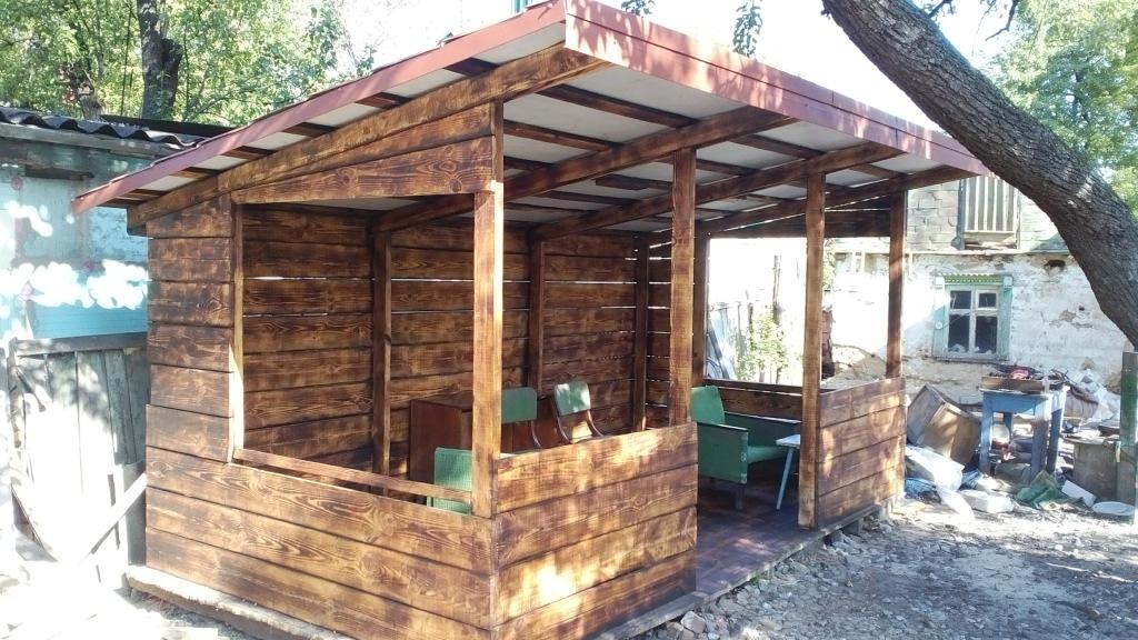

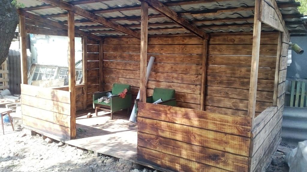

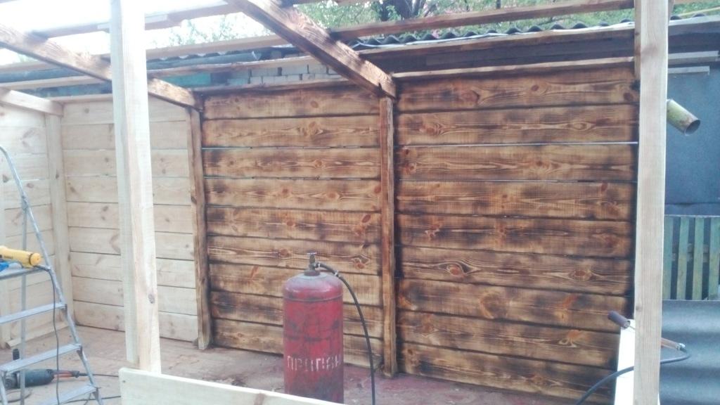

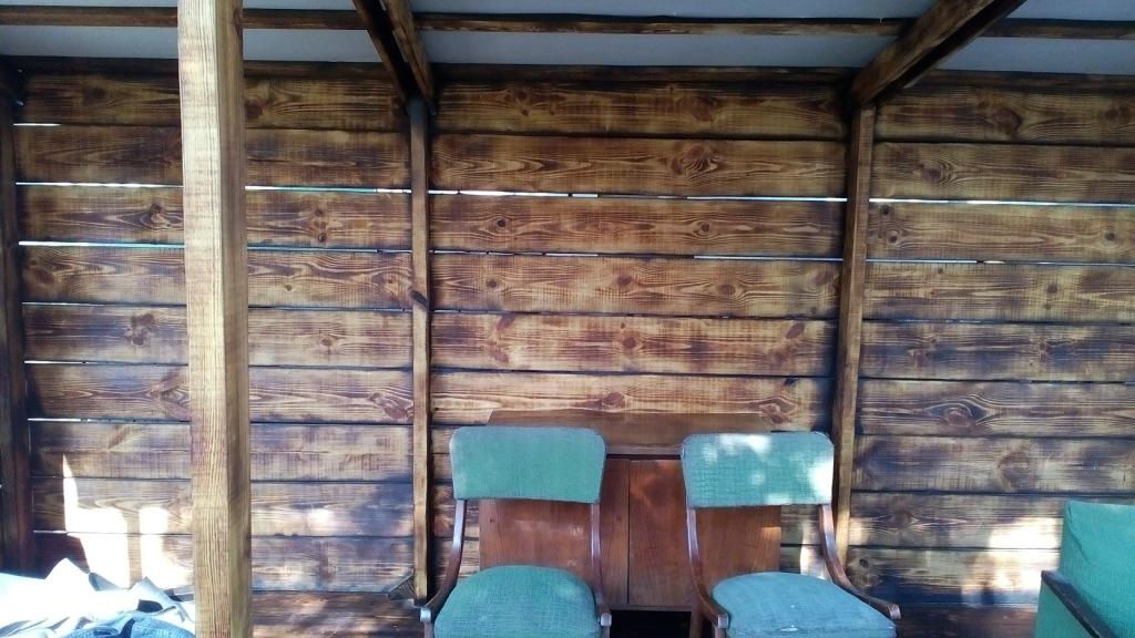

Шліфували дошки пелюстковими тарільчатими кругами, шліфувальними кругами на липучці. Краску з 50-ти річної підлоги теж знімали тарільчатим пелюстковим кругом, але напевно є інші варіанти. Можливо як би був піскоструй, то краску напевно було б краще ним знімати.
Далі, видимі частини бесідки опалив газовою горілкою до проявлення чітких контурів волокон, а тильну частину та лаги під накриттям - обвуглив.
Обробили антисептиком і покрили оліфою (трофейна трилітрова банка від попередніх власників).

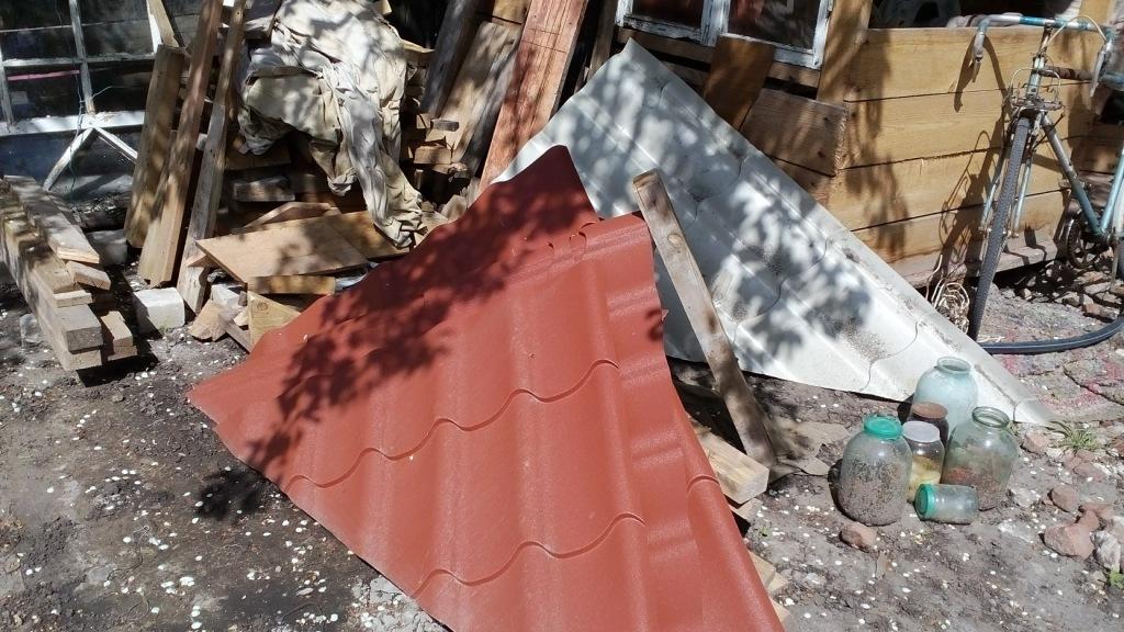

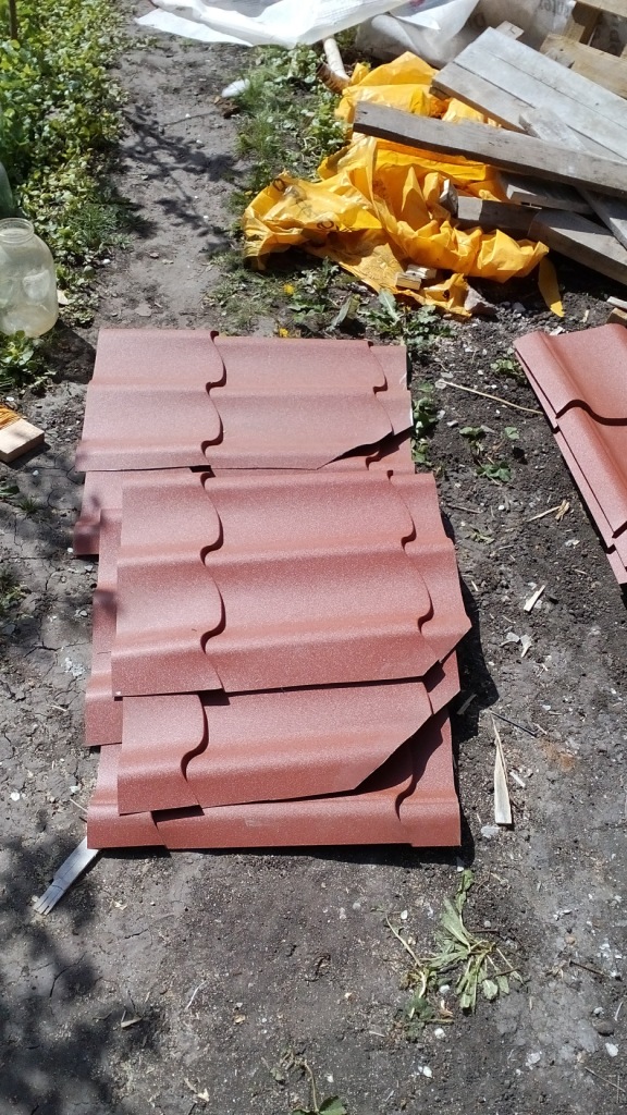

Під покрівлю настилив паробарєр, і з залишків металочерепиці від вальмової покрівлі зробив "мозаїку". Кілька було листів цілих але коротких, решта вирізав із кутових обрізків. Якщо є два переходи а також дві хвилі - можна використовувати
Ось такий вийшов результат. Всі шліфувальні роботи, покриття антисептиком та оліфою виконувала дружина, а я лише ошмалив і зробив покрівлю.

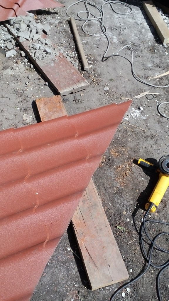

Не хочу прослыть занудой, но вроде как МЧ резать болгаркой нельзя :D
Можна, якщо не абразивним кругом
Так, для основної покрівлі не можна різати, якщо у вас мають бути вузькі коньки, чи нахлест одного листа на інший меньше 10 см. Основна причина, по якій не можна різати абразивним кругом криється в тому, що при різанні іскри попадають на захисний шар фарби і там появляється іржа. Якщо місце різу буде перекриватись більше ніж на десять сантиметрів, то з нею нічого не станеться.
Більше того, навіть нержавіючий метал не бажано різати звичайним абразивним кругом, оскільки в зоні різу зявляться цяточки іржі (полоса близько 5-7 см). Для різання нержавіючих металів потрібно використовувати абразивні круги які не містять заліза, сірки і хлору.
А якщо це тимчасова покрівля на тимчасовій будові, то яка різниця чим різати? Навіть якщо вона 10 років з кусочків простоїть, її все одно так чи інакше потрібно викидати.
Основная причина почему этого не следует делать, что при сильном нагреве во время реза в этом месте испаряется пассивирующий слой. Для этого толковые кровели и применяют высечные ножницы. Краска скорее для эстетики. У моего соседа почти половина краски с металлочерепицы давно слезла, но следов ржавчины разумеется нет.
І з цієї причини теж...

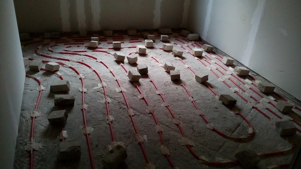

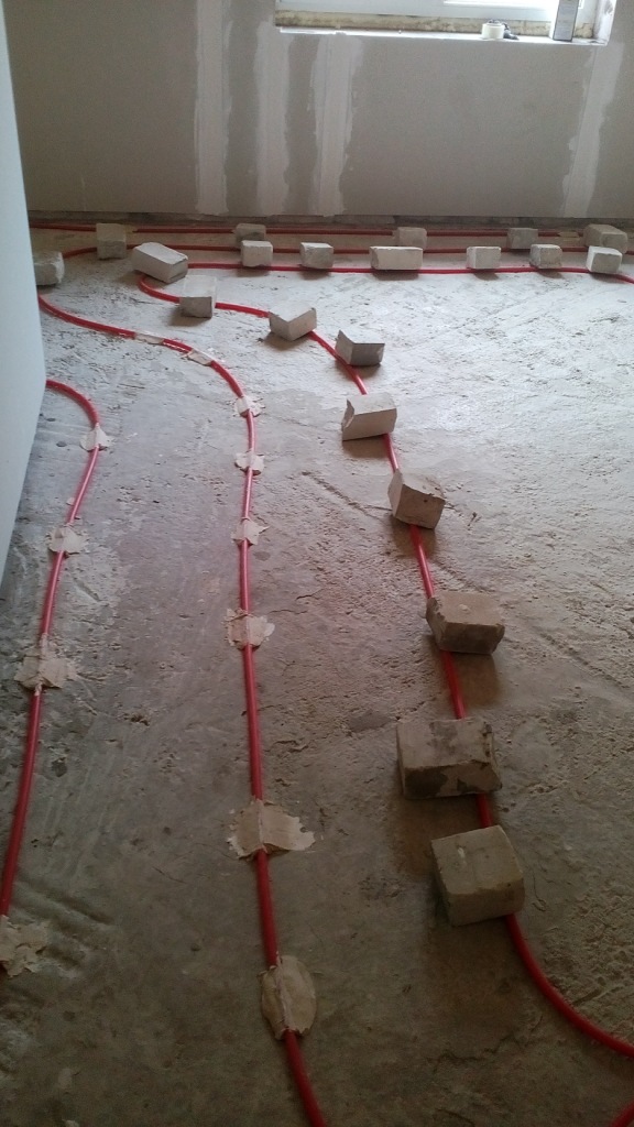

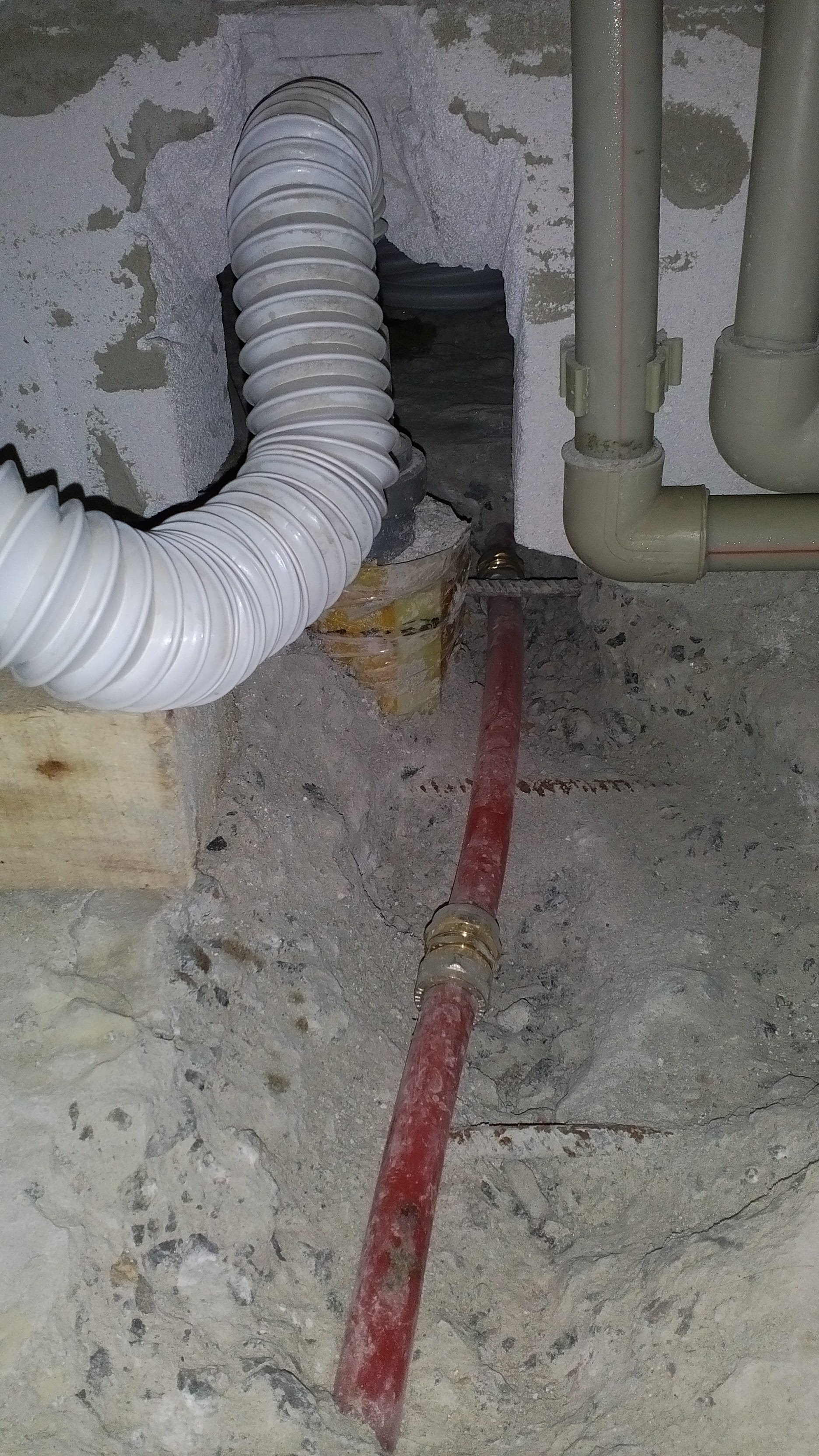

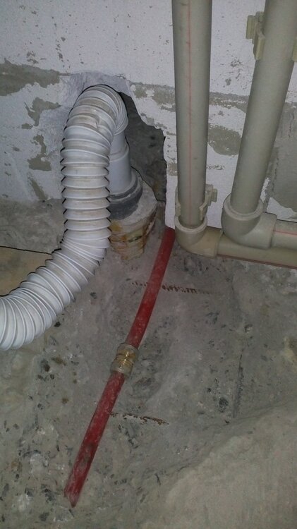

Що планую. Єможливість ще зробити стяжку від 2 см до 5 см по всій плиті. Думаю перевірити тиском хоча б на 5 атмосферах і вже після цього робити чистову стяжку, або ж якщо виявиться хоча б ще два-три нових пориви при такому тиску, поновому розмотати трубу і також зробити чистову стяжку.
Хто міг би порекомендувати де Дніпрі взяти на кілька днів опресовочний апарат? Можливо є якісь ремонтні рідини, які дозволяють мілкі тріщини затягувати?

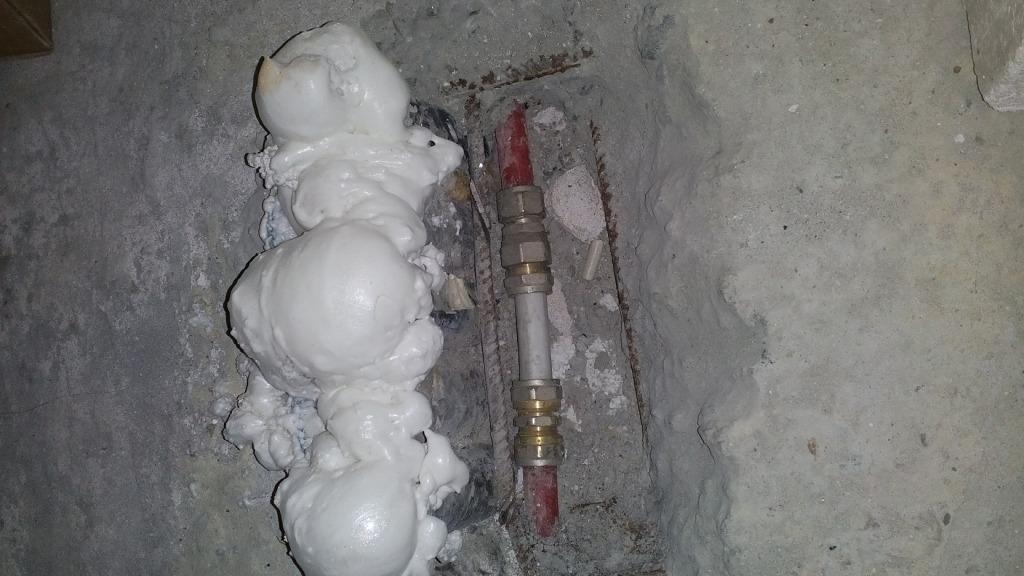

Мне кажется или Вы отремонтировали систему компрессионными(обжимными) фитингами? Если я прав, то Вам не страшно монолитить такие соединения?
Я знаю, где можно взять инструмент (в том числе пресс-клещи для натяжных гильз) Рехау в Днепре. В магазине Астер например. Можно ли взять его у них, ничего не купив из продукции Рехау, я правда не знаю...
Я ещё тогда читал и удивлялся - неужели пронесло...
Ні, не пронесло....
Я в принципі не планував їх монолітити з точки зору майбутнього теоретичного можливого обслуговування (над самою реалізацією ще не думав), але що може з ними статись, якщо замонолітити?
Їх знаю, але вони лише монтажникам дають таке обладнання, які з ними постійно співпрацюють...
Ничего. Просто потекут. Любое резьбовое соединение - обслуживаемое.
Я не монтажник. Мне дают.
Значить не їх монолітити, зроблю обслуговуваним (якщо по вновоуму трубу не потрібно буде укладати)...
Потрібно буде до них заїхати...
формально - да.
но вопрос, когда же наконец потекут самые обычные резьбовые фитинги самой обычной МП трубы, которые я купил в магазине рядом с домом и которые заменили собой сталюку водоподачи в квартире в хххх году ?
они, я так понял, уже смонтированны, но ещё не замоноличены.
значит пройдётесь, подтянете пока оно открыто и всё.
металл не настолько пластичен, чтобы деформироваться одинаково на протяжении всего срока службы.
основная деформация - дни а даже не недели после первого монтажа.
потом этот процесс настолько мизерен, что можно пренебрегать
мне кажется, что есть и компании занимаеющиеся прокатом оборудования. Да, на клещах может не будет написано Rehau, но прессовать будет норм
Западло - оно избирательное. Бывает заглянет, а бывает в игнор поставит. Если захотите замонолитить подобное соединение у себя, или спрятать гибкие шланги в оплётке за гипсокартоном например, то лично я не возражаю.
В Киеве точно есть. У нас не встречал.
Вот тут не факт. Инструментом Рехау можно нормально опрессовать систему Голан аквапекс например, вроде бы кое-как в раскарячку ТЕСЕ, но точно нельзя КАН. Да и глупо это. Фитинги стоят дурных денег и насиловать их неподходящим инструментом стрёмно.
Порядок дій по підлозі бачу наступним:
1) перевірка тиском
2) якщо норм - стяжка з ревізіями (лучше перебдеть чем недобдеть)
3) якщо ні - то нові труби і тоді вже не має значення все що знизу...
Думаю перед испытанием будет уместно пару раз нагреть и охладить систему ( для обжима)
Нагрев -охлаждение ( туда сюда)

Вирішив навіть не випробовувати, а закласти взагалі нову трубу.
Планувалась чистова стяжка в межах 1,5 см-3,5 см (є перепади по всій площі плити), але буду робити 3 - 5 см, тому нова труба повинна лягти нормально. Крім того знайшов для себе новий спосіб кріплення труби теплої підлоги до бетону без вяких забурювань і решти відомих методів - клей для гіпсокартону PERLFIX і стара цегла. Метод такий: накладаю на бетонну підлогу "ляпку" клею, розладаю трубу, прикладаю на участку без клею цеглиною і так.д. За 30 хв не відірвеш... Перевірив на невеликій "петлі" труби теплої підлоги - ледве потім видалив... Фото укладки викладу пізніше, коли буду укладати трубу.

Як я вже писав раніше, вирішив не ризикувати а закласти нові труби теплої підлоги. Цього разу придбав трубу теплої підлоги "Розма" по 12 грн/метр.
Загальний перепад по всій площі плити складає 2 см в різних місцях. З врахуванням закладки нових труб теплої підлоги, стяжка буде коливатись від 3 см до 5 см. В кімнаті, яка першою потрапила під чистову стяжку, товщина стяжки слала 5 см.

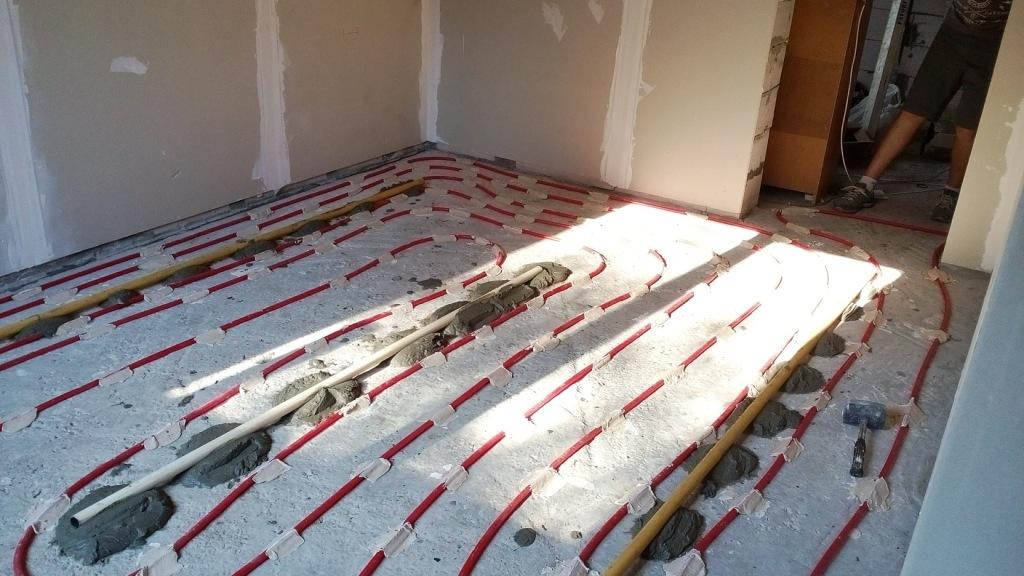

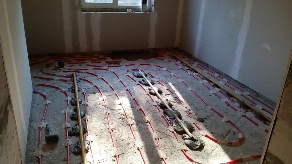

Тепер що до нового методу укладки труб теплої підлоги. Кріпив до бетону за допомогою клейової суміші PERLFIX (клей для гіпсокартону). Спочатку сам метод мене бісив, але вже до кінця розкладки я призвичаївся і нерви теж заспокоїлись. Під'єднав до системи, подали тиск. Стабільний...
Особисто мені сподобалась така розкладка, тримає клей дуже міцно після тверднення. Мінус такого кріплення - довго (на поклейку всіх труб в кімнаті в мене зайняло 4 години), а також, якщо буде багато з бетону виділятись та стікати багато води, крайні "ляпки" можуть відклеїтись. За весь час заливки, кріплення відклеїлось лише в одному місці біля входу в кімнату.
xWD0fzEwnG6fBRoMdS1LGpsGs8TszaXsL9zUwDHacQPbqEAL4X53ko4YHKvcZaKDUhuxQRPvENTpuURgFF4dn3spaqKk1v9OHe-3RqpagZugZidQn6MAmOYGiEe2N3j-8FgyhUcallUOaSwsURNIVIy3cT7YRosnBWz6V8jgOsPb8VPiB7d6QuEsvJGHjvFBux-mV0devuQ-WTp4UKBA4j76APw0p8Rlu8TsK6jw57xaK_ozDsyYNC3s5p3wTR1wlBYst16-Td-B0zkGw9ctsI4X8g3_V84Niy59Zm9WeL2hLwoTglzHjgYIdkbA74rFIj-vt_sek_-d84KMw4BmfCgaLbtbtI-fe4bK_NyX63IvXhhMgXVZ6Myo8pMMGQw-1-3emGTfLdo3xBQCtaJ1fihCESjKta3GrJi87M9U1jL3RUP6aAMW560B3jn3yNmLcSLs0XD9qP2WaxmW6g4QrdZrOh4rDxkZIgmMnPKDn33k9E01yDEwjIfDDdQvpaG16sNsBM-uYzyHGDzGQavfO5aUiLqqZtk3vn7GhSJ7Xcs9HwE8hr1vIynOOT5XUJYN45Ihz2TM9AtdJG62tYR5KKVJVGgfokVvIvpnIIcxUM9Q5L4n=w1177-h662-no
GIljGn6QJsR3oLTy_PMdHMobbXaa86R0BpVpg5PlPj6JnXIP9mxPA8GwftmIZKU_6kxPzMaNBJUwVEGnkUYEqXc3hImGj9MO1Bw4zE0ppzW7CVrV17kURL_gFLiy6vmlZ69k31vT8QfBWcCKAxPKGHxXVt-Fa7t-L1_YFwg8xss9xmkVhQLaa4T-9CkqVeVRpYVqd6oX53T7rMeA7EDli95kzTHZ04djzZBX7ynHGz5eS9mMN1aT-yxXa9LXGwSPtGFYqhICM1T8lTIGj_b8FyLkWRvj9inhFiBbX1ALlUupHtFfOXRGGU8bKsNgNkAdM9mzpZvH9CYQXf8wKtpZQgb197ibSagK2Dc28-gUSdAyh57jTzI4TRkZgVObKG5t4U0c36Q2IH3qgH_0Y50D3s1LVKzkwGCFTqkmRVgpKIn9t9QwZPT8L3RQYlFmucucRuNChrIZijFi_3xnli_XIvp-6SLKc9qUc4xXW2dvD4tn3HSu4wEDjDgOKX3DfIRGbiBi0vSxY31y_s4rTP75i0uCM9nDGEm-oI3fXUn_kNXmkcixo76xYto4XiA30TcbBIWk4CymZ6YzoFEIqWTiyxGCb3kj-tF3Vx7HihiGwDpkSTI5=w1177-h662-no

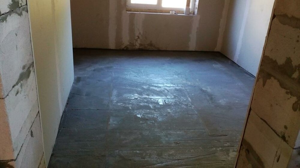

З металевих труб зі старого будинку зробив маяки, заливаємо.
На площу 16 м2 пішло 7-мішків цементу Б-Ш 400 і 56 десятилітрових відер річкового піску та 300 грам мікрофібри. По часу заливки - чтри робітники та чотири години роботи.
Z4-JkqliSCzZFdT9tjacN2ReLj_fStXvXUZmz15fIAkIIvYzLcaHl7p_LyZvYUH5Sigy-mcZEwU12UfV50RBUchOf_FvJwAl4TalOpysSlj5NYPcr4NdurhCVX-y73Oot64-d2916OWgkTFHSJZTFQ-v6jCSj-FRV-RiU2BaMB5sfVO1IerhPeeX0bX_mlo8Z1K-D1Zt7INajYRegpxaVCK8N5fmAjdYuEnkrtwNkIXtSwShUHGpQ9Ss8ZQ3M6SS2bv6kogxwAaU4Oc70uLmXPCrOt1-MTm81PFn61oeyIPTVTT8VtYyvtpaPdkeeU1SBSj6j7CJCjBgL8VBQ69aXVjGAAwZS6khFoZ4Q3nKt5owWxpklyiwtdwkq01Hp_smWKVkSHSxn_ZVA2plRhZ-ZvrmMfrA3zXQOJMAKkEbflKLyBpyOERp8xfHarN1OTMlrwW7Wlg_i2zlLq37tcjpRPaSHF0c88sSwE9sDvEsx54XEXTF4a-XH1wPTpF7FKByvxppLXyoC2XYCDb9ipeP_n46ITKCf0WwYe5sDiAbpNj8pQbsGZUlpsVVDRNxKxhGsn_af3tTGG1humDUWaD5EFwDyAcjz5AmKMl3HGcB0dhdqK66=w1177-h662-no
yY6kPXVhwLj7j9LNVxMuNel0ZUNbrB3nnAhuJ4H20tqaqy_d1EnCS5vOVi5UiM7Y5yO9-VbvQ1rOt9EufTt75pYcn0I-3vleH9tQH2etfeuUVKN9xHJvbqJ2ks8m8EYEXom3oE8PVk5J6IuVBVYIZvwCKXDb-xZqBx4j6RQqLIHDP7RokMgkmGi8SAs9z-fo6t86DiTlYPBtXyDZemgsevEHue9ivEy8gRKf08nrZ2iuhEIymalddVwWODXY2zopHuyT5qOYk1EiWo-tI52JHF9QJnJCp6qJcMTTJI9RtBTThMXvKWsSC-Slaqheg25JY_95SQIrlqz9IfkrTO-vjrWw3kEEJUAPU6GVIl4oJ02-6MLTDFOIW0jC04bwomGYHJVqbI03eyx_QdU1AZ-EITPvPYSNDZCzX2rrDL1d4Wj9kS8sDONNjDJZ2LNH0XHRnTZGfmtZf8dLzvypUVWrNpNMpclTmqh5VLFsDyHAiXSW7yGNNgWzx7ibC-uzzPu-6mW7Yv6Mu6TYoBHlUnbZUNCsQfsWydguNsNZFkql21mfdIHIDRht-RRYtWRAHwOVx77bGAm1bXCBCZDMIwSS1wuSPeOV06qMSIiTP1CCYmFzIxbw=w1177-h662-no
Результат заливки
miwwWcXBtZcrr_N262AwKXZm9er-LQ35O9IZhyo54zprq9WysF98BwU9FyTb4qG-XBP8wmX9UOjiRFusuNiNQnOFIxw8i64wMa2h8L5M6H6CSxYstL4StXyInqqNFHi0qQrHaiPLF6HxcIK2Un8Vso33J9CWbI1-S73IJQ3k_c1tY6Bh0jL78ASFhvyOhB6Q5AWaM_mvn-ApsbJ9_pTplbSDMwyinXzVkOHnvpEDbwpPuWtxanrYOmUonbYU8va5uemYB6uato6m6HEUkeJzRSUdVGPeAZEaRIUfJwwOFt9fAvhGdVafQcGY9DAvZYwGpVqwBS45rK7IvE2wcjCdtcpZPasY8ukmCJlBcUD4cRkPkhXUZ98juZMpbVApA4Iegb_X3AmxHgmtGtujz0rnztMYjIHSRSDcrqkxVGQQQ1-IkmnMQMSIbJf45cI8hZSEBPv4UC651YWBBmGMXHtGGJp0-5XzRPGB4yL2CImu4Nokv52Yoim8_6L0Uhpk3L-ceugDAGHJxUWDgSBJfY2tqY1AFZy5lZMRjtUH2y3pn3vjO3cecL-2hFq_U5sAvp2c2kLnY1a72ab4saXRTid6LboirBRtzs9kqZ0zRK1ss-nYQz3gUJOr=w1177-h662-no
Сьогодні демонтую маяки та підрівняю правилом по свіжому...
