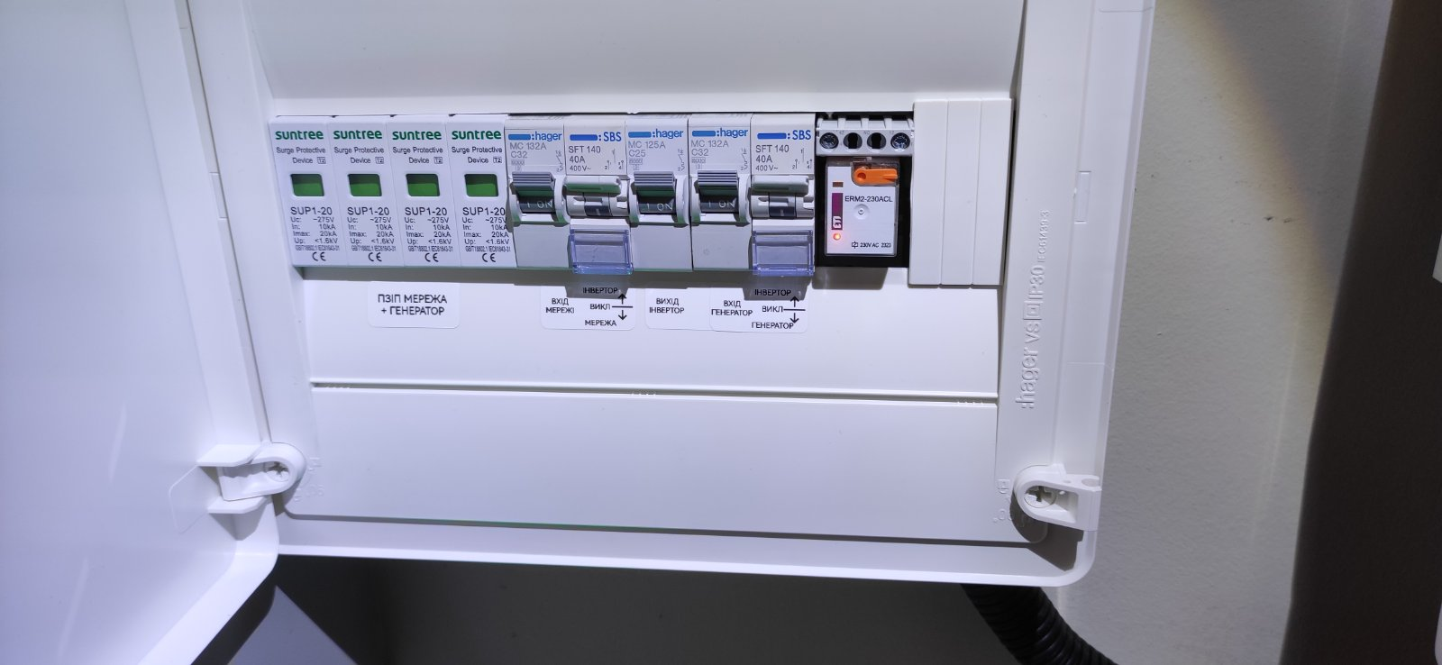

2 минуты назад, blacktigra сказал:
А підкажіть будь ласка яка функція у реле?
то завязка з генератором
  • Дякую 1
9 годин тому, Dalet сказав:
Акуратно зроблено.
То дистанційне заглушування, чи запуск, чи управління АВР генератора ?
УЗІП на генератор, круть

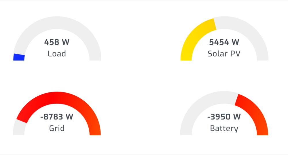

Знайшов багу в Deye, коли той працює в режимі Selling first.
Ось такий лист накатав в підтримку:
Цитата
Dear Deye team,
I've been using Deye SUN 10K-SG04LP3-EU "Zero Export to CT" mode since May. I have Essential and Non-essential loads connected to my inverter, also I have a 20 kWh Lithium battery.  Everything worked as expected and I could clearly see consumption of essential and non-essential loads.
Recently my energy meter was updated to a bi-derectional one, so I checked "Solar sell" to sell excessive energy to the grid. Again everything worked as expected and I could clearly see the power of my essential and non-essential loads.
Yesterday I decided to switch to "Selling first" because I want to charge batteries only if PV power exceeds AC power. Everything worked fine till the moment when my hot water heater turned on. The heater is on the non-essential circuit and for some reason Deye inverter stopped adding power of non-essential loads (including the water heater) to the total load power. On the inverter's display I saw export to the grid, but in reality my house was pulling power from the grid. So my water heater is 3 kW, my essential loads were 0.5 kW and solar provided near 2.5 kW, and on the Deye's display I saw 2 kW exported to the grid, however in reality my house was pulling 1 kW from the grid and I could clearly see that on the utility energy meter.
It looks like a software bug so the inverter doesn't take CT measurements into the total load calculation. Could you confirm that this is a software issue? And if yes, was it fixed in a newer firmware version?
15 минут назад, volomoto сказал:
CT встановлено біля лічильника? Між лічильником і бойлером?
59 хвилин тому, volomoto сказав:
Поки в мене дейе працював як мережевий без продажу він нормально рахував все що проходило на вхід в будинок, і те що було до нього увімкнено і те що на бекапі. А потім я не пам'ятаю - чи при початку продажу чи вжен коли я додав акуми він перестав правильно рахувати те що увімкнено між СТ та інвертером.
  • Конфуз 1
8 минут назад, volomoto сказал:
Так
Проишивку не оновлювали? просто цікаво - це в свіжих таке, чи просто ПО застаріле
3 години тому, k-master сказав:
Неправильно рахує чи взагалі не враховує те, увімкнено між СТ та інвертером? Бо в мене друге і це якось тупо.
2 години тому, beavis сказав:
Не оновлював ще і якраз виясняю із сапортом чи це пофіксали в прошивці.
1 минуту назад, volomoto сказал:
Сапорт там так собі, може і не знати. Я кидав лінк на чат, де можна попросити оновити. Можете ризикнути)
8 хвилин тому, volomoto сказав:
01,02,2023- по даним інвертора постійне споживання десь 5 кВт(опалення). Тобто 5*24=96. Він нарахував  споживання від мережі - 14. Вироблено 34, продано 27. Де він ті 14 взяв я не знаю. В мене було враження що він то рахує, то не рахує. Я потім просто придбав ще один лічильник щоб рахувати без інвертора, правда поки не поставив.
Змінено користувачем k-master
19 хвилин тому, k-master сказав:
Це якась повна дичина. Я б тут також писав в сапорт
22 години тому, volomoto сказав:
Після довгих пояснень із записом відео отримав таку відповідь від саппорту:
Цитата
Sorry, I was not understanding the problem before, this is normal.
Selling first mode will only show critical loads.
Тобто для правильної статистики потрібен додатковий лічильник і танці з бубном, бо дані будуть йти з різних джерел і їх треба буде якось джойнити на дашборді.
Зараз мені той Selling first ні в що не впирається, але вже десь з травня в мене сонця буде більше, ніж вихідної AC потужності інвертора, тому хочеться надлишок зберігати в акумуляторі, а потім цей надлишок продавати коли сонця вже мало. Швидше за все на цей час переключу бойлер на гарантований вихід, тоді вся статистика буде правильно рахуватись.
